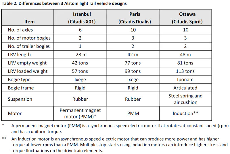

I have been away for a bit, so I am just catching up on this thread. There seems to be some confusion about the Citadis SPIRIT verses other Citadis trams. In particular, I am reading comments like this one, which is in regards to the design of the bogies of the SPIRIT: “Hard to call the design faulty when it has been used without issues for many years on other trainsets.”
This shows that there is still a lack of understanding about how much of the SPIRIT is different from previous Citadis models. Here is a table from the Transportation Safety Board of Canada letter to the City of Ottawa, dated February 3, 2023:
Note the various differences – particularly that the bogies ARE NOT the same ones used on the other Citadis trams. In fact, the SPIRIT is the only Alstom vehicle, that I can find, that uses this new design, the IPONAM bogie. (If you find another tram using this bogie, please let me know. Look for the tell-tale ‘fender flares’, which are necessary to house the large outboard motors on the IPONAM.)
So, you might ask, why does the SPIRIT use a different bogie from other Citadis models? Because Ottawa specified a Light Rail Vehicle that didn’t exist. (And even with the unique bogie, the City had to reduce its specified requirements.)
Anyone who tells you that there is no design flaw because the bogies work fine on other vehicles, is missing the information that the SPIRIT bogies are a new design, introduced on Ottawa’s version of the Citadis SPIRIT.
Thank you for the details.
If you go back to the original post (#3286), you will see that it was a comment about a faulty bearing assembly (not bogie). I would have to look back, but I a pretty sure that I had read that this bearing assembly has been used in other bogies. It is quite possible that it wasn't appropriate to use this bearing assembly in the Iponam bogie (I don't have access to all of the technical documentation to know for sure), but that isn't the same as being a faulty bearing design (a nit pick I know).
As for why the city is paying, we don't know all that happened behind the scenes at the time. For all we know, it could be that the risk of this type of failure was brought to the city, and they signed off on it, as they didn't want delays in vehicle design and were insistent on using LRT vehicles that didn't exist, even if the experts said that they weren't appropriate.

I take your point, and agree that it is a nit-pick. Just because, for example, SKF makes all manner of excellent, well-designed, bearings, it doesn’t mean that all of them are applicable to every situation. To argue semantics, that a particular Bearing Assembly does not have a design flaw – even though it has perhaps been used in an application for which it is unsuitable – does not make a machine’s overall design more reliable; particularly when it is that Bearing Assembly that is repeatedly failing in that machine.
The City of Ottawa asked for a 100% low-floor Light Rail Vehicle (LRV) which could carry more people at a higher speed than any LRV in existence. And it had to do so with high rates of acceleration and deceleration. This necessitated a vehicle that is larger and heavier than the existing Citadis trams that Alstom offered. The low-floor requirement could be met by the existing Ixege bogies but not the other requirements. Thus, Alstom set about creating the Ixege POur North AMerica (IPONAM) bogie.
The IPONAM is kind of the heavy-duty version of the Ixege bogie. They share some traits and components, but differ in others so that the IPONAM can handle heavier loads and faster speeds. Unfortunately, one of the components that was carried over was the Axle-to-Wheel’s Bearing Assembly. Just as no-one would expect a rear axle from an F150 to survive in an F350 (being used for actual work, not just driving back and forth to the office on city streets), no-one should expect the Bearing Assembly of the Ixege to survive the increased forces that the IPONAM must endure.
This is a design error by Alstom. In the Transportation Safety Board of Canada’s letter, it was stated that the Bearing Assembly did not show a single point of excessive wear, but undue wear globally. This supports the claim that there was not a flaw in the design of the original Bearing Assembly – but reinforces that the Bearing Assembly installed is not up to the task.
