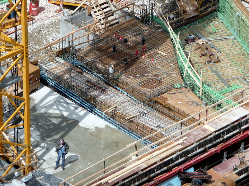

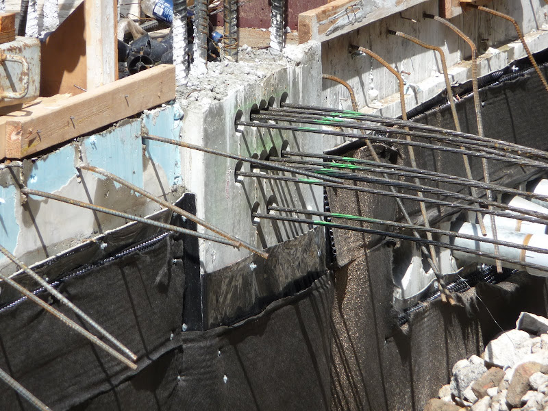

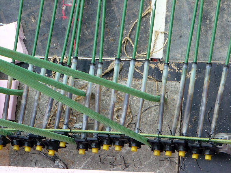

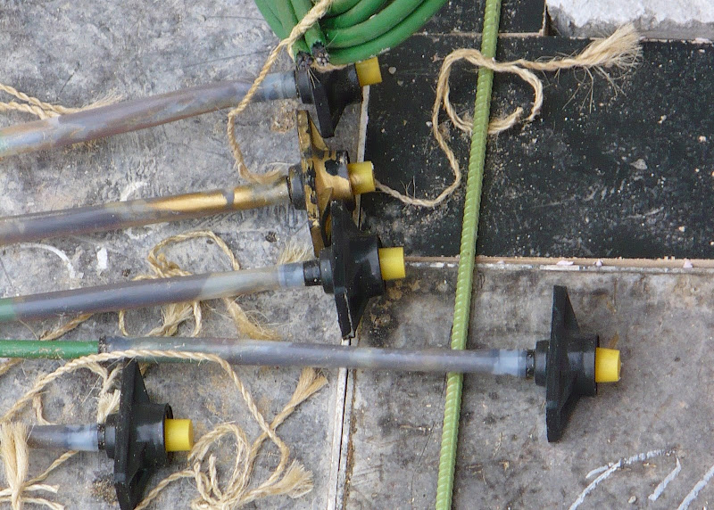

Very good question, I haven't been able to catch the actual tighting process (yet).
Here are a few shots of the layout.
Aqua
1
2
2
4
5
6
And after
161 W Kinzie
This series 400 N Dearborn Rising shows the layout on the standard floor plate well.
In this frame you can see the coiled up sleeves in the upper frame, and stretched out on the lower part.

Refer also to HarryC's excellent montage. In the case of PT, flexible ducts are laid with the rebar (epoxy coated green rebar in this case). These ducts can also be ribbed to develop anchorage with the concrete. The ducts may already have the steel tendons inset prior to the pour or they can be pushed in after the pour.
Once the concrete is hardened and developed sufficient strength, then the anchors/wedges are set at each end and the tendons are jacked (against the edge of the slab). The wedges have little teeth on them so as to prevent the tendon from slipping back once the jacks are removed.
The final process is to then grout the interior of the tube, so as to fill the space left inside the duct and the steel tendon. As Slide-Rule indicated, improper grouting can be a disaster waiting to happen if not done correctly (and it's a mess to fix). An alternative to grouting is "greasing" or using a thick grease pumped into the cavity which will hopefully remove air and water. Greased PT conduit has the advantage of allowing tendons to be removed in the future if problems occur. However a properly laid duct with properly positioned vents and properly "cleaned" prior to grouting will almost always be a problem-free installation.

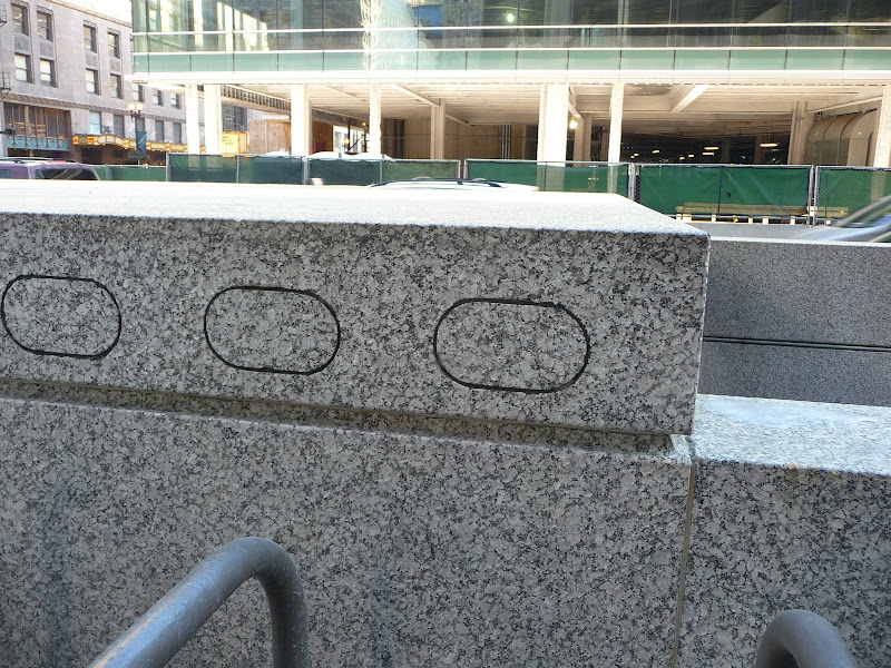

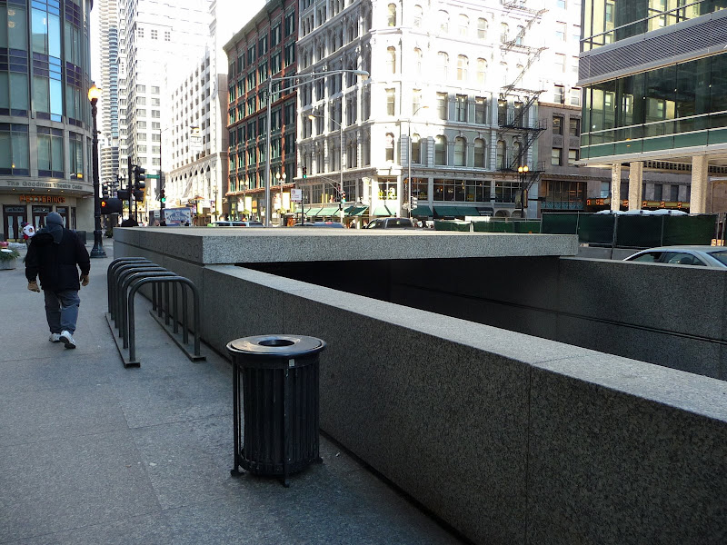

Post Tension Granite
The slabs over the garage entrances for Daley plaza are post tension granite.
the covers

OK - I'll bite! Why are the granite slabs over the parking garage entries at Daley Plaza post-tensioned?

Well perhaps it is still a "brittle" material, but the tensile strength of granite and similar rock is in the range of 4 - 8 MPa (as compared to concrete that would be 1 - 3 MPa). For the application shown it still appears to be gratuitous overkill given the thickness of the slab used, the support arrangement (e.g. pinned on 3 edges, fixed on one), and the fact that there appears to be no additional or superimposed load acting on the surface.
Even without the PT, the FOS would be ~3 as a conservative estimate (from my basic calcs) against a service load crack.

Next obvious question for the uninformed...How exactly does one go about post-tensioning granite?

u bore holes through it

That's my point - it doesn't appear to require the assistance of PT. The tensile capacity of the material is more than adequate and even if you wanted to guard against a freak failure, why not just slide a few channel sections in under the slab hidden from view and doesn't involve the additional expense.
Span to depth is pretty modest (about 12 or 15 to 1), so it still defies logic. An FOS of 3 (or even more) is superb, so again PT appears to be an expensive solution with little reason to substantiate it. So the question remains - why PT it?
To expand on Vexx's question - a series of holes are drilled through the slab but each would also require a counter bore at each end in which to accept the strand anchors. The photo shows each strand pocket capped with an epoxy sealant to keep it air tight, so it (the strand) may not need to be grouted. However, it may not be prudent to rely on said sealant, so grouting the hole seems warranted. To do that though, there would have to be a second grout tube and vent drilled alongside each primary hole - which probably explains the oblong shape of the cap.

Ahh, makes sense now. I'm an idiot...I didn't realize those were caps on the end of the granite. The first time I looked the photo it appeared as though something had been punched through, similar to a large hypodermic needle...I guess the simplest explanation is usually the best.
