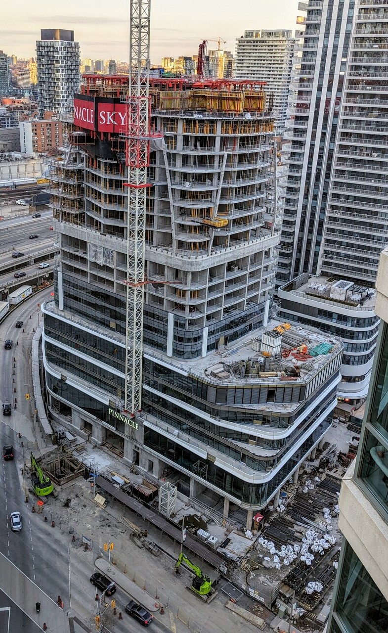

There is no strict, absolute height limit for a tower built on a transfer slab. In modern structural engineering, transfer slabs (or beams) are used to support supertall skyscrapers, often allowing them to reach 400+ meters (1,300+ feet) and over 100 stories. The limit is determined by economics, structural efficiency, and the ability of the slab and supporting columns below to carry the immense vertical and lateral loads.
Key Factors and Examples:
100+ Stories: The 106-story Pinnacle Sky Tower in Toronto, at approximately 352 meters, is a recent example of a massive tower resting on a transfer system, allowing the residential tower to have a different grid than the lower levels.
Supertall Applications: Transfer slabs are frequently used to transition from commercial spaces (wide columns) to residential/hotel spaces (narrower columns). They are routinely utilized in 10- to 30-story residential buildings and can be engineered for much taller structures.
Design Limitations: The main constraints are the thickness of the transfer slab (often 2-3 meters thick) and the load capacity of the columns and foundations below it.
Structural Considerations:
Positioning: The most demanding loads often occur when the transfer slab is positioned around 40% of the building's total height, requiring robust engineering to manage drift and shear.
Load Distribution: Transfer slabs (or "foundations in the sky") allow for massive loads to be redistributed from the dense tower layout above to a different column arrangement in the parking or lobby areas below.
While technically feasible to go higher, engineering requirements for safety and structural integrity dictate the practical height limit, which in the current era has reached 300-400+ meters.
https://www.google.com/search?q=what%27s...L8QUmGTRWfTpviw&sourceid=chrome&ie=UTF-8
Side note: SkyTower uses a lot of sheer walls for structural rigidity.
